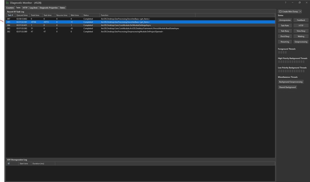

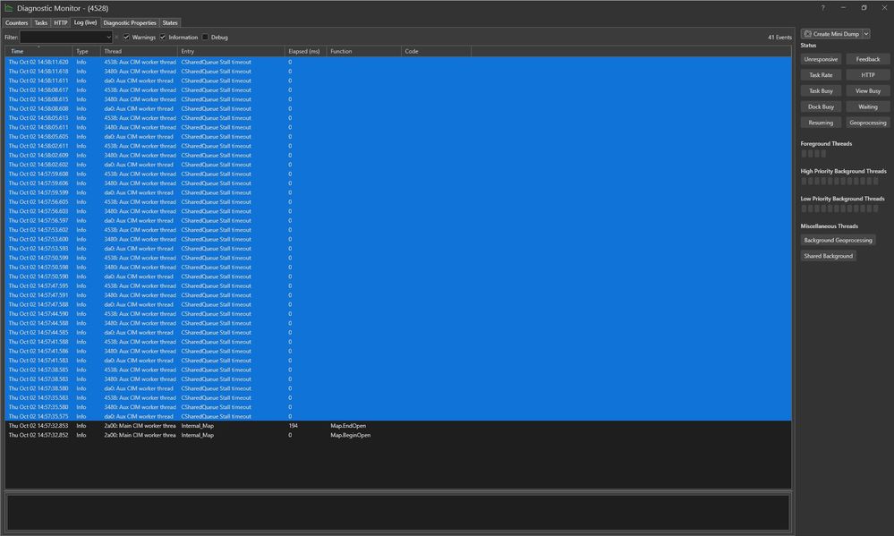

I have attached screenshots of the Diagnostic Monitor showing the elapsed time and log showing there is a CSharedQueue Stall timeout that repeats during this delay.    It's got me scratching my head.
