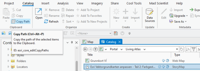

@LyonMNGIS it isn't in the context menu, but you asked for "Copy URL" from Catalog view which is already possible:
Copy Path copies the URL and you can paste that into a browser.

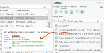

From the Catalog pane, with the pop-up enabled you can click the item's url and open the storymap from there:
LyonMNGIS
@KoryKramer
Thank you for pointing it that I can use "Copy Path."
Just my two cents...  I personally only use the "Catalog View" and not the "Catalog Pane."  The functionality in the Catalog Pane works exactly as I would otherwise want within the Catalog View.  Can that be ported over?

Hello @LyonMNGIS
When working with portal items in the Catalog pane, Copy Path is not yet available. And similarly, the link to the portal item's URL is not yet clickable in the Catalog view. We do plan to make these capabilities available in a future release of ArcGIS Pro.
However, I wanted to note that a deliberate change was made with ArcGIS Pro 3.7 where portal items that are not directly supported in ArcGIS Pro will no longer appear when you access items in the active portal in the Catalog windows. For example, this means you won't be able to see or open Story Maps from ArcGIS Pro when you are accessing content from the Living Atlas.
