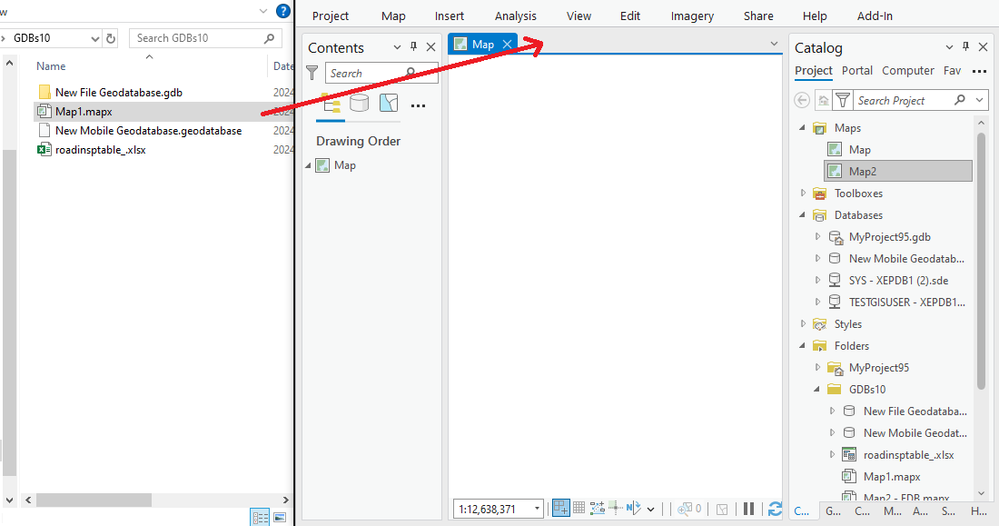

With a .LYRX file, I can drag the file from File Explorer into [the map or Contents pane] without issue.

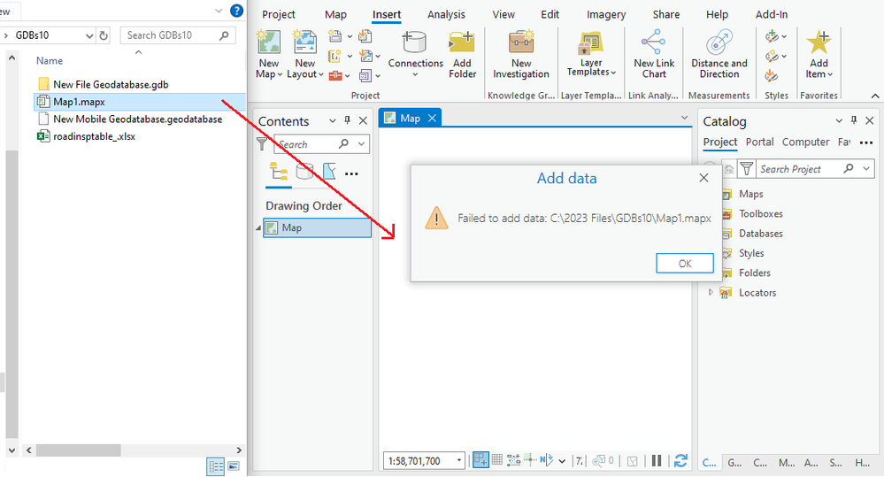

However, .MAPX files don't seem to have the same functionality. I get an error when I try to drag and drop a .MAPX file from File Explorer into [the map or Contents pane]:
Error:
Failed to add data: C:\...\Map1.mapx.
Could that functionality be added to .MAPX files too?
I'm aware that I can open the .MAPX file [by right-clicking the map name in] Catalog. But my intuition is to drag the file from File Explorer [into the map or Contents], just like I do with .LYRX files.

You can indeed drag a .MAPX file from File Explorer to the Catalog pane or a Catalog view in an ArcGIS Pro project, which would add the map to the project and open a map view for it.  From your screenshot and the error message, it seems that you were trying to drag a .MAPX file onto a Map view in a project.  This would not work, because you cannot add a map to another map.  You can drag a .LYRX file to a Map view, because a layer can indeed be added to a map.
Please let us know if I misunderstood your suggestion.  Thank for your feedback.

Also, could the error message be more descriptive? As in, inform the user why dragging a .MAPX to an existing map didn't work.
