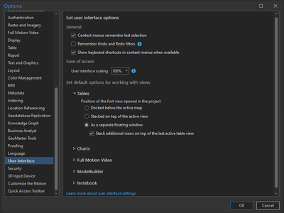

Hi @Bud . Have you seen these options? Setting "Tables" to 'As a separate floating window' and checking the option below should let you achieve that behaviour by default. No drag-and-drop needed and map frame unchanged.

Thanks @LindsayRaabe_FPCWA. That helps.
