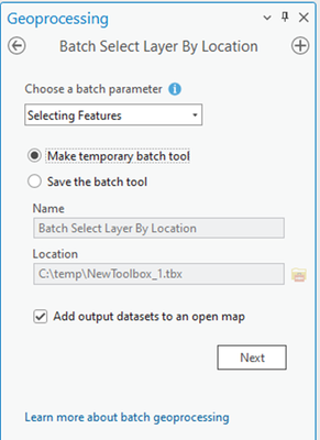

Hello @RobinHolland thank you for the question. Geoprocessing tools can be run in batch mode, which allows you to run the same tool multiple times using different input datasets or parameter settings. When you create a batch tool, you can choose the parameter that will drive the batch process, this is the value that will change each time the tool runs. All the other parameters will remain constant for each run.
In your example, here is how you can use a batch tool:
  1. Right-click Select Layer By Location in the geoprocessing pane and select Batch
  2. A page will open where you can choose which parameters will drive the batch process. Under Choose a Batch Parameter, you can choose Selecting Features (as shown in the screenshot above). In your case, I would suggest saving the Batch tool, then you can specify the new batch tool name and the toolbox where it will be saved.
  3. This will open the Batch Select Layer By Location tool. I tried to recreate your example in the screenshot below.
Note: Use Add to the current selection for the Selection Typeso that each successive selection adds to the overall selected features.
You can learn more about the Batch geoprocessing in the documentation: https://pro.arcgis.com/en/pro-app/latest/help/analysis/geoprocessing/basics/batch-geoprocessing.htm

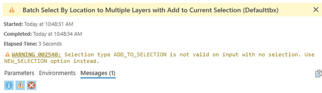

Thank You! The procedure you sent seems to have worked. I was missing the final piece of choosing Add to the Current Selection. When I ran it with New Selection yesterday, I only got a selection of those features which were located within 500 feet of a stream and a lake both. Today with Add to the Current Selection, I finally got the full selection of those features located within 500 ft of a stream OR a lake. Interesting thing to note is that even though it worked, I did get a warning stating the selection type of Add to Selection was not valid.
It still selected the number of features I was expecting, so I am not sure why it gave me the warning. Thank you for the help!
