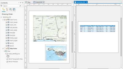

@DougBrowning @PhilipMarty @JenMar_  Ah, I couldn't resist so I created a very simple script that creates 2 pages for every page in a map series.  The first is a map centric page based on a map series and the second page is a dynamic table (also based on a map series).  Both pages are synchronized to use the same map series page number.  They both don't need to use a map series.  You can use whatever logic you want.
Here is a snippet of code that does it all:

#Landscape layout with dynamic Map Series table
lyt2 = p.listLayouts('TableData_MS')[0]
ms2 = lyt2.mapSeries
#Portrait layout with Main Map Frame and Locator Map Frame with map series
lyt1 = p.listLayouts('Layout_MS')[0]
ms1 = lyt1.mapSeries

PhilipMarty
@JeffBarrettethis is terrific! Thank you so much. My code block was almost identical to the one you typed out. The missing link was ms2.currentPageNumber = pageNum to tie each map series together. Very cool stuff. I tied that in there, and it worked beautifully this morning.
