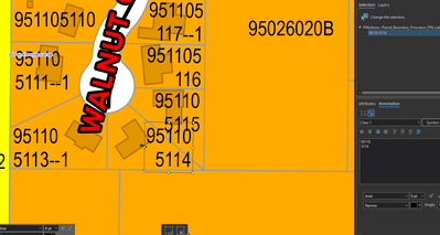

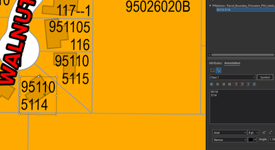

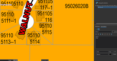

When changing the alignment of multi-line annotation text, do not move the text box. Ex this annotation label begins left aligned:
Center aligning shifts it right:
Right aligning moves it further right:
Ideally, it would just stay put and align right as may be expected.

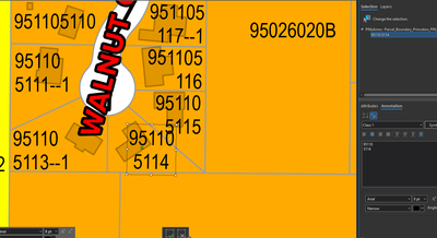

Want to point out that this is also a problem in normal graphic text.
The anchor point of the text box does not matter; it has the same problem no matter it is anchored.
Text left-aligned
Text right-aligned
