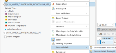

I usually convert my labels to graphics, which allows better placement without hassle. I love graphic labels. Just right click on your layer in the Table of Contents pane, and  choose Convert Labels, Convert Lables to Graphics.
