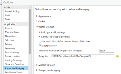

PaulPrevedoros1
To all I found the location
Cheers
PaulPrevedoros1
2nd Update despite performing the change to local directory as above (and restarting program as stated)

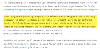

ElizabethGraham
Hi Paul,
You can set a system environment variable to change the location the distance tools, and other tools that use parallel processing, write.
Distance Allocation help documentation:
Liz
KoryKramer
This is documented in the help that Liz shared above.
This had previously been logged as a bug with technical support, and that bug was closed, guiding users to set the temp directory as a system environment variable that Pro respects: https://support.esri.com/en/bugs/nimbus/QlVHLTAwMDExMjAyOQ==
[BUG-000112029: Unable to set the location of the temporary directory used by ArcGIS Pro.]
