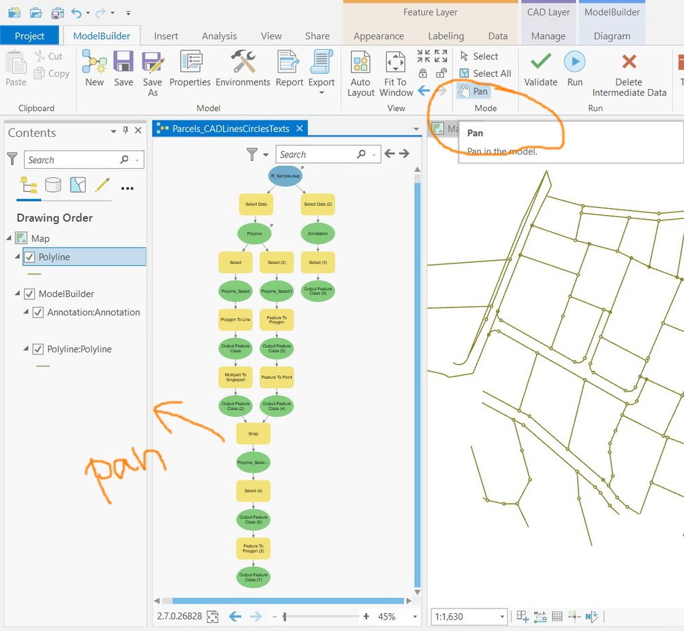

JamalNUMAN
ArcGIS Pro 2.5: Pro fails to pan in model builder as it is used to work in ArcMap,
For example, in the screenshot below, panning from down to up is not possible in Pro while it can be performed decently in ArcMap. Panning in ArcMap in all directions in much more decent than Pro
Is this by design or something that needs to be enhanced?
MarcoBoeringa
Jamal NUMAN‌,
I wonder if this is a regression bug in Pro 2.5? I am still at 2.4, and in a similar case, I can pan through the model, and the Pan tool isn't disabled as it is in your screenshot.
Can you also confirm that you were able to do this in 2.4?
Screenshot from my Pro 2.4:
KoryKramer
Thank you for responding to help, Marco Boeringa‌!  This is a continuation of this duplicate idea https://community.esri.com/ideas/18254
Pan works, but the current limitation is that you can only pan to the extent of the model, and not continue panning further...

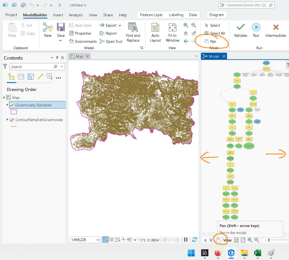

JamalNUMAN
The “pan” issue appears not to be enhanced in 2.7!
JamalNUMAN
Not implemented in 2.8.4
JamalNUMAN
Not in 3.0
JamalNUMAN
Not even in 3.1.5
JamalNUMAN
Not even in 3.4.3
