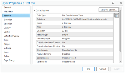

For what it's worth, file geodatabase views don't have the Query section in the Properties —> Source tab:
