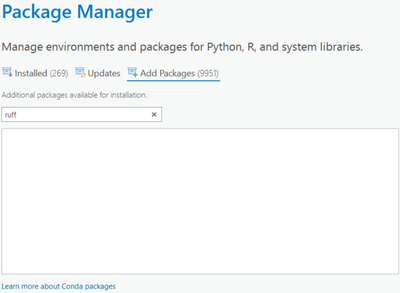

skykasko
@HannesZiegler: ruff is still not showing up for me as a package that's available to install in the ArcGIS Pro Package Manager. I am on ArcGIS Pro version 3.3.2.
HannesZiegler
@skykasko I confirmed that in 3.3 ruff does not show up in the backstage, but it does show up in 3.4 (next release). You should be able to install it now using the command prompt:
Using a clone of arcgispro-py3 (do not modify arcgispro-py3 directly)
  1. Open Python Command Prompt
  2. Activate the clone by running: activate <your clone name>
  3. Install ruff by running: conda install ruff
