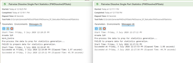

LindsayRaabe_FPCWA

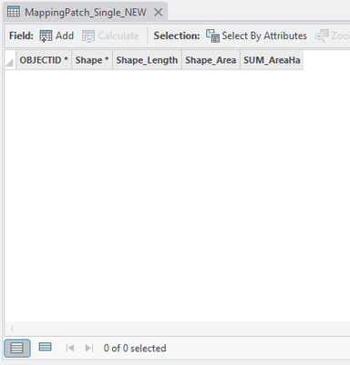

Thanks Ken. Gave it a whirl but something didn't go right. Ran "successfully" but output dataset was empty.
Tried a couple of times - once with and once without any dissolve fields selected.

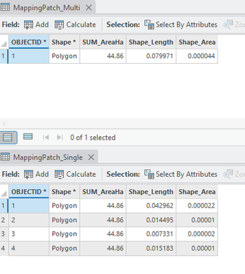

What the 'factory' Pairwise Dissolve tool produces for comparison (with flawed stat for the Single option).
KenHartling
Thx @LindsayRaabe_FPCWA . It's failing in the preparation step.
Would you be able to share your data and the parameters you used?
