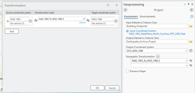

In ArcGIS Pro 3.4, there is a transformation control on geoprocessing tools (like Project or Project Raster) that you can use to select the source and target coordinate systems, and an appropriate transformation for the data.
https://pro.arcgis.com/en/pro-app/latest/help/analysis/geoprocessing/basics/geographic-transformatio...
