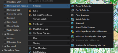

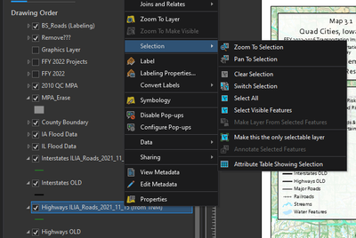

For some reason the Make Layer From Selected Features option is grayed out when you're working in a layout. You have to open the map, where it functions properly.
Layout:
Map:
15 Comments
Robert_LeClair
One workaround is in the Layout, click the Layout tab and in the Map group, select Activate.  Once activated, you can then do a right-click - "Make Layer From Selected Features"  No need to open the map.
