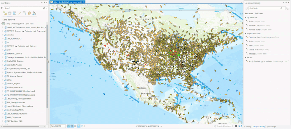

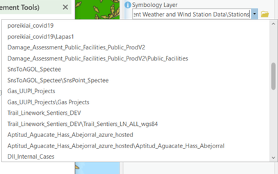

I did some further troubleshooting of this problem and the tool is far speedier when I perform the operation in a new map with none of my online data sources. I'm not much of a programmer, but this suggests to me that there is some sort of verification of each of these sources happening before the list of available layers can be populated? Couldn't there be some more efficient way of holding a layer list in memory that does not have to be verified every single time I need to select a layer? I would even be willing to sacrifice speed in the event that I did happen to select an online data source (although not the minute-and-a-half it was taking per symbol transfer), if it didn't take this long EVERY time I tried to copy symbols while committing the cardinal sin of having background data in my map.

It would still be good to get some specific details in terms of the number of layers you have in the map and exactly where you see the lag - i.e. is it in populating the Symbology Layer dropdown?

How many layers are in the map?  Here is a quick test that I just did in ArcGIS Pro 2.8.3.  There are 30 layers from ArcGIS Online.  The tool's dropdown list is responsive and it took 0.21 seconds to execute.
Is your workflow substantially different from the above?  Are you working with hundreds of layers?
We are interested in understanding your specific situation, but we will need the reproducible case.  If you're able to share a project package and steps that clearly demonstrate the issue, please share those with me at [email protected].  Otherwise, you can work with Technical Support to troubleshoot the issue.
