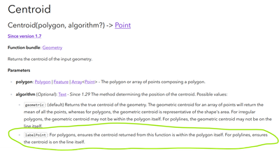

Now available starting with Arcade 1.29, ArcPro 3.5 etc.

Hi @DaleJackan_work! I'm closing this Idea as Implemented since this is now available with Arcade 1.29 as noted in your comment. Thanks!
Relevant documentation for reference: https://developers.arcgis.com/arcade/guide/release-notes/#version-129
