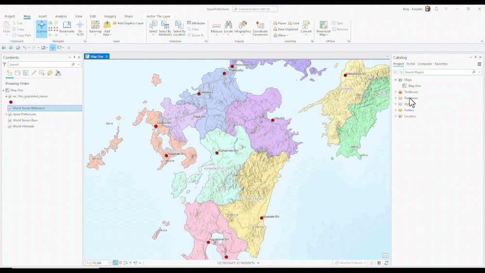

KoryKramer
@DiogoFnds just a note that your idea was merged with this existing idea, so please be sure to add your kudos to this one to show your support. Just a note that while the idea's title asks to lock the layout, it is really about locking map frames that reference the same map, whether they are in the same layout or multiple layouts.
Regarding that knowledge article that you cited, that seems outdated to me - having to save a mapx file and import it certainly does seem onerous and is not necessary. You can just drag and drop a map into the same Maps container to create a copy very quickly. Then adjust the layers as needed. Point map frames in layouts to the corresponding maps as needed.
When you say "I just wanted to print a single A0 layout with several regions separated in different frames, with different layers turned on or off," does every map frame/region have different layers displaying? For example, you could already have different views from the same Map for Region 1, Region 2, Region 3, etc. But the reason this doesn't work for you is because for each of your map frames, you need to display different layers. Can you show some examples of that? How many layers are you working with, and does every map frame have a different combination of layers you'd be displaying?
When you say "I wouldn't duplicate a map and create multiple map references in the same layout just for this," is it because of the number of regions? Would this mean copying your map 5 times? 25 times? What is the pain point with having a map specific to each region that can be completely customized without affecting other maps?
We've been discussing this idea quite a bit lately, so I'm genuinely interested in learning more about your specific case. Feel free to respond here, or if you feel it would be more helpful, I'm always happy to set up a screenshare - you can private message me if that works better for you.
Thanks! 
