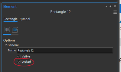

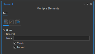

@wayfaringrob I'm late to this party, but I do have a solution. Open the individual element's properties and check the "Locked" box in the Properties window. Pro 3.5.1

wayfaringrob
@FourCornersMapping  yeah, that’s just way more tedious than it has to be.
FourCornersMapping
@wayfaringrob I agree, but you can also select more than one or all elements in the group and do the same procedure (just check Locked).
