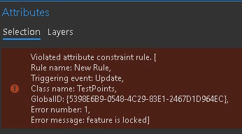

This works great for manual edits, as it throws an error in you face, telling you why the edit was blocked:
But it also throws that error for automated edits, which is bad, because the script/tool will stop at the first locked feature.
