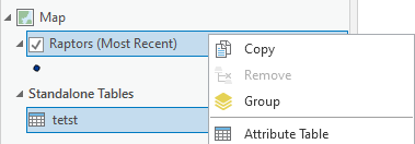

Pretty simple: I want to be able to remove tables and layers from the map at the same time. Currently, you can either remove layers or remove tables, but when you try to remove them both, the option is greyed out.
Pressing the Delete key only removes the layers.
Please add in this functionality to streamline workflows.

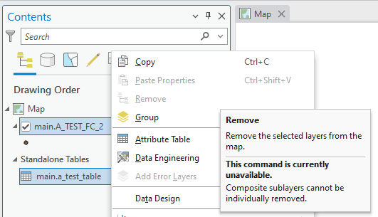

ArcGIS Pro 3.2:
In the Contents pane, if I have multiple FCs selected, I can remove them from the map using the context menu —> Remove.
However, if the selection includes both FCs and standalone tables, then those items can't be removed. The Remove option in the context menu is greyed out.
Tooltip: (when hovering over the Remove context menu option)
This command is currently unavailable.
Composite sublayers cannot be individually removed.
Could that behavior be changed so that we can remove both FCs and tables at the same time?
