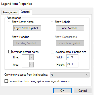

Can we have the "Only show classes from this heading" feature that was available in ArcMap back?

Currently in Pro, I need to go to the More menu, to turn off the All other values, or go to symbology and remove there manually, but what about a setting in the legend properties to turn this capability off,  I want this capability to be more intuitive.

The option exists in ArcGis Desktop for the legend option to only show classes from heading, please add this to Pro.
