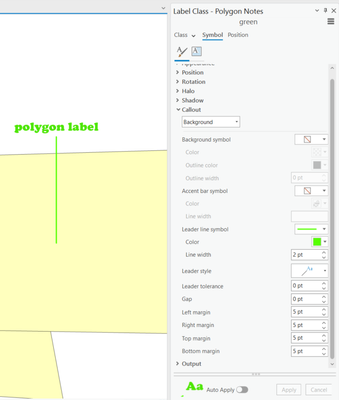

Closing this one out as the original idea is offered in ArcGIS Pro.  Further ideas can be logged separately
GISAdminSHN
@WendyHarrison when I use the Mid leader style instead of the Base leader style it still seems to be far too sensitive and grab corner basepoints rather than midpoints:
As shown here, the angle of the leader allows ELECTRICAL PANEL to stay on midpoint, but even a slight change from that apparent limit gets me the abomination that is PAD MOUNTED TRANSFORMER's base snapped leader. Is there a way to suppress base leader positions when using the Mid leader style? Thanks!
