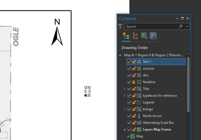

Pro 3.1 - the select by rectangle (layout) tool does not pick up empty point text. They're selectable in the TOC, but this isn't always desirable - especially in a sea of 'Text 1' 'Text 2' etc (related idea: ArcGIS PRO Layout Text Improvement - Esri Community ) and when you know where the empty text is and are trying to just get rid of it. It would make sense if you could select them right on the layout with the select tool.

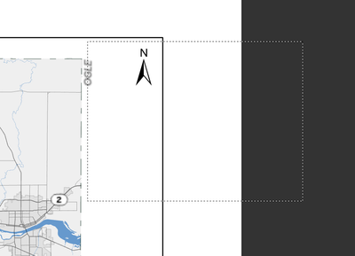

Ex. drawing this box selects only the map frame and north arrow:
Have to select the empty text from TOC.

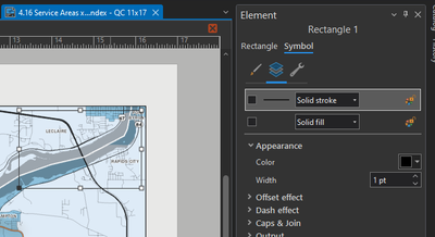

@AubriOtis  also noticing that if you turn off all symbol layers in a map graphic, it becomes unselectable. Ctrl+A grabs it but then you have to Ctrl+click every other graphic to isolate it since they don't show up in the TOC either.
Setting the symbol layers to transparent rather than turning them off keeps the selectability.
