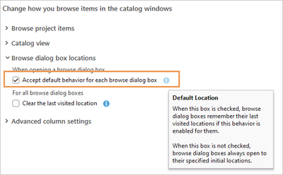

TimOrmsby
Hi Andrew,
Unchecking this setting in the catalog browsing options might be useful to you. It doesn't directly address your suggestions, but does allow you to stop browse dialog boxes from returning to previous locations.

andrewdc_tt
@TimOrmsby that does help with the issue for the moment, thanks. It is annoying that the dialog can't remember without it being buggy/lagging though, so the idea request still stands.
