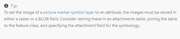

If I understand the request correctly (i.e. maybe instead of "label" a feature, you want to symbolize a feature using an attached photo as the symbol) this is possible with ArcGIS Pro 2.7's addition of the ability to drive picture markers through attribute-driven symbology.
This is summarized in the what's new help as:
Maybe that will not address every need for those upvoting this idea, but hopefully it will help provide a solution for some users!

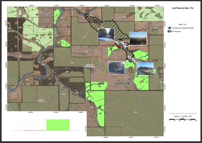

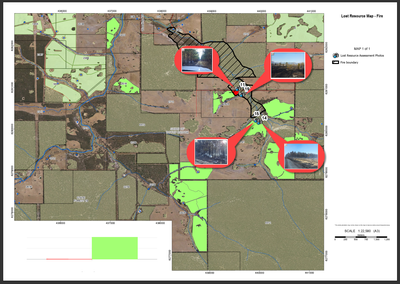

It would be great if in ArcGIS Pro we could display feature attachments (images) in a callout pointing back to the feature containing it. This would be great for maps we make showing fire damage where field staff attach photos to points in Field Maps and in the office we produce damage assessments.
Settings could let you specify callout sizes, arrangement, tolerances, buffers, overlaps (all very similar to labelling options) as well as how you want an image to fit within a callout (fill, gaps, rotation, etc).
