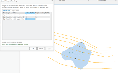

MattSmith
An mockup of what it might look like...

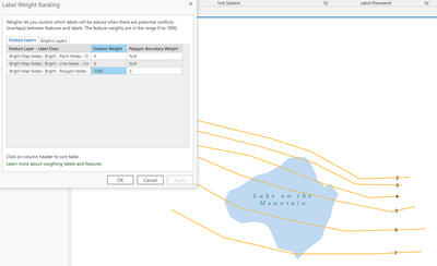

WendyHarrison
Hi
This is possible to do with feature weights.
https://pro.arcgis.com/en/pro-app/latest/help/mapping/text/weight-labels-and-features.htm
a value of 1000 will block other layer labels from placing over those features, but still allow the label for the feature to place.
See mockup below.  the lake label places, but the contour labels move once the lake layer feature class is set to a 1000 weight
