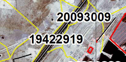

As shown in the attached image, the label leaders cross. I'm using Maplex. A search of the forums and help does not offer instruction how to set Maplex to avoid this.

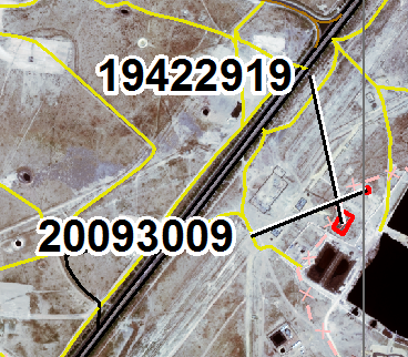

If I use standard labeling, one label loses a leader but at least the positioning makes sense:
Please ensure Maplex does not produce overlapping leaders.

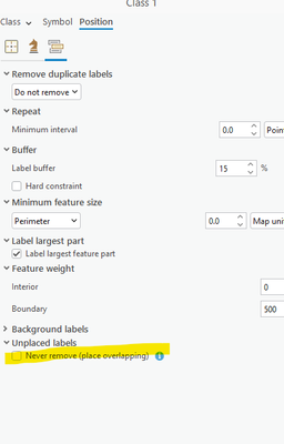

The Ideas site is meant for enhancement requests to the software - new functionality.  Crossed leader lines are not normal and if we have a case of them it will be considered a bug and a reproducible case needs to go through Technical Support.
We need to figure out why you are seeing the leader lines cross.  Do you have the Never remove setting enabled?  This would be the first thing to look at and having it checked will result in crossed leader lines as the label will place instead of going unplaced due to the crossed leader lines. See image below

CalvinHarmin
@WendyHarrison Thank you, that is exactly the kind of basic information we were looking for! It wasn't apparent to me that this rule is the only thing preventing/allowing crossed leader lines, as place overlapping option overrides other proximity issues in addition to leader lines.
The documentation you linked doesn't mention callout/leader lines but now it makes more sense to me. That would be great to have this issue added to documentation as well.
Given that info, I wonder if we ought to create a new idea that increases the granularity of these rules regarding 'forced label drawing' beyond this one monolithic option. I wonder if there could be sub-options that, for example, do not allow crossing leader lines in particular while still forcing all labels to draw.
This probably means such an option would have to make exceptions or trade-offs, that maybe the user could provide weights for these exceptions. For example, make offset value exceptions (more or greater than what is defined in preferred/maximum offset), or 'External Zones' exceptions to force placement of callouts in different angles around a feature beyond what the user specifies. Things like that would be great to have to dial in callout labels a bit further.

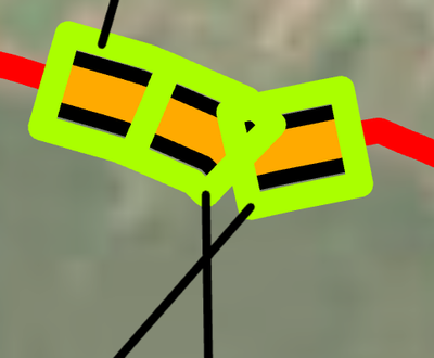

They still cross:
