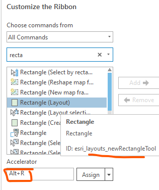

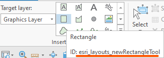

In ArcGIS Pro, the graphic rectangle ID is esri_layouts_newRectangleTool:
I can assign a keyboard accelerator to that command:
