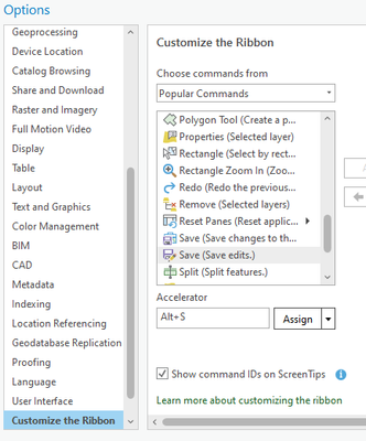

It is possible to assign a keyboard shortcut to save edits by using accelerators.
See https://pro.arcgis.com/en/pro-app/latest/get-started/customize-the-ribbon.htm#ESRI_SECTION1_0B9AD340...
Below I assigned Alt+S to the Save Edits command.  That now works as my shortcut.
Is that what you're looking for?

@KoryKramer that's it. I was having the hardest time finding the pro version of the customize menu, sorry
KoryKramer
Thanks for the confirmation @anna_garrett No need to apologize.   Glad you're able to do what you need to now.
