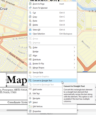

This is available with the new convert text type context menu shortcuts in ArcGIS Pro 3.3.
