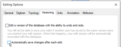

@DavidWheelock2 "can it be made so that the user can make this setting persistent across sessions without having to wait for an admin to do it?" >>
Yes. Remember that the application management settings that can be controlled by an admin are only exposing options that are already available to the individual user. So in this case, any individual user can just go in and control the option themselves:
(Preview from development builds. The UI in 3.2 may be different.)
Now... if an admin sets this up a certain way and LOCKS the setting, then the individual will not be able to change it.
Does that answer your question? Is that what you meant by "persistent across sessions"?
DavidWheelock2
Hi @KoryKramer.
What I'm suggesting is actually an improvement on ArcMap.  Allow me to compare.
ArcMap
Let's summarize ArcMap behavior, first.  In ArcMap the default when working with non-versioned SDE data is to automatically save edits immediately.
However, you can turn that off so that it will prompt you to save or discard edits at the end of the edit session.  Even so, that setting only persists as an attribute of that MXD.  So every time you open that MXD your setting will persist.  However, if you open ArcMap fresh, without an MXD, then it defaults back to automatically-save and you have to turn that off yet again.
ArcGIS Pro
Currently ArcGIS Pro immediately auto-saves all edits to non-versioned SDE data without giving the user a way to turn that off.
I would like ArcGIS Pro to do at least what ArcMap currently does, but also to allow the user to turn off auto-save so that it persists through ALL edit sessions, without having to turn off auto-save every time you start a new project.
It sounds like that's what ESRI is doing with these changes but I just wanted to be clear.
