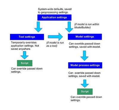

“The screenshot below shows all the places in which geoprocessing environment settings can be defined within ArcGIS Pro.
Whilst it is possible to define the application settings (top level) using ArcPy via the user interface, it isn’t possible to programmatically do this with ArcPy. Unfortunately, this workflow is not currently supported, however it is a valid enhancement, therefore we would recommend that you log it as an idea on the Esri Community page.”
