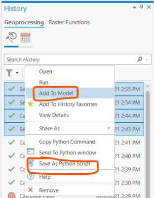

For #3, if I understand correctly, this is already possible.

Thanks Kory. I am aware of those options but I have not had luck in the past.  I am testing it now. I will update my post once I know the results.
RobertHursey

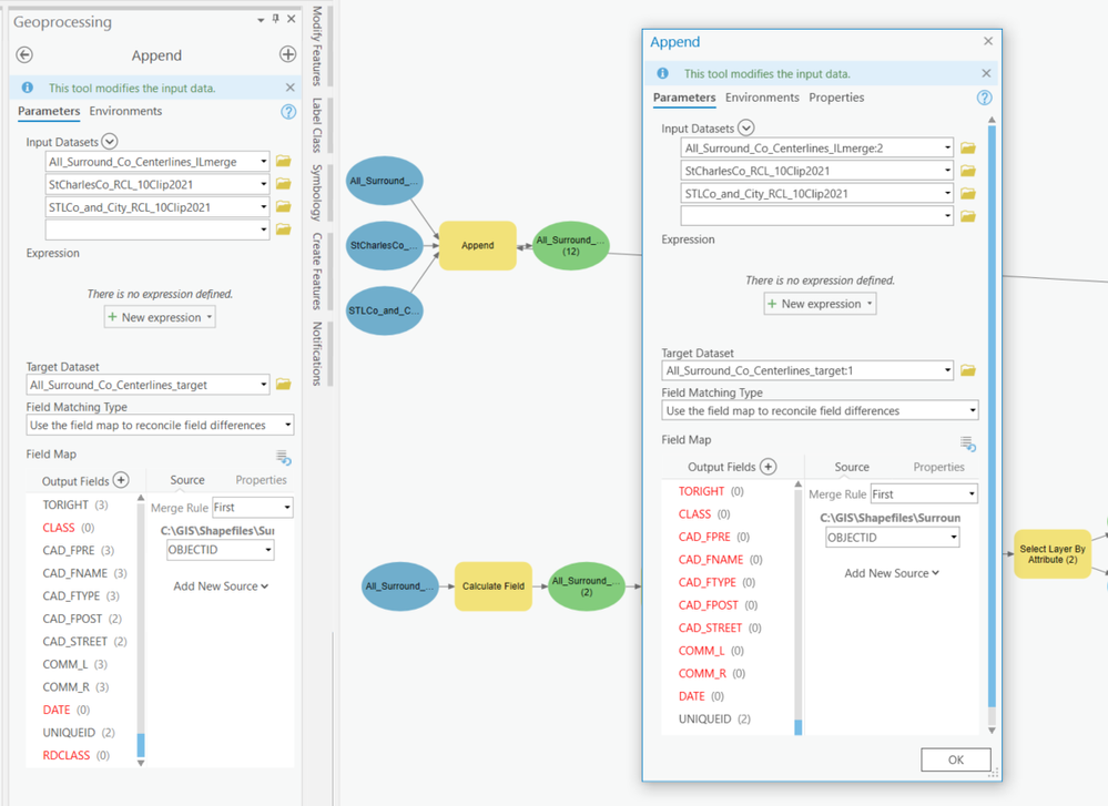

Kory, I have removed #3.  After some trial and error, I was able to create a model from the history entries, but I did have some trouble.  It appears saving from history to a model does not keep field mapping from the append tool.  This is a pretty major limitation, but after I realized what was going on, I was able to remove that entry and run just the field calculations which really speeds up my workflow.

Thanks Kory. I am on v2.8.2 currently and I am positive the field mapping did not keep because when I run append outside of the model it works, however, inside of the model fields were all left blank, so opened the gp tool within the model and the field mapping I set up manually was all gone.  I will try to add a screen shot but I am about out of time today.  I am going to split this out into 2 ideas and maybe someone can look further into the field mapping.

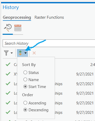

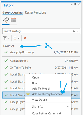

Thanks for your post @RobertHursey . I just want to point out a few features of Geoprocessing History that relate somewhat to your requests.
You can currently change the Sort option of history based on a few options:
And you can also make some tools as History Favorites, which elevates them to a top Favorites section.

Kory, Here is a screen shot of my append issue. On the left is the way I set it up.  On the riht is after loading to model builder.
