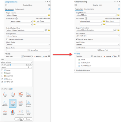

This idea is in the product plan for the ArcGIS Pro 3.6 release. In the Spatial Join tool, you will be able to add multiple Join Features and specify a custom the Join Count Field Name for each feature.
Also, as of Pro 3.2, you can use Add Fields on the Field Map to quickly summarize attributes in a join feature

Hello, this idea is implemented as of ArcGIS Pro 3.6. You can now specify multiple Join Features and the join_count field name
