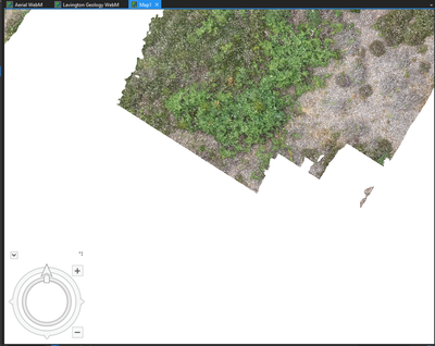

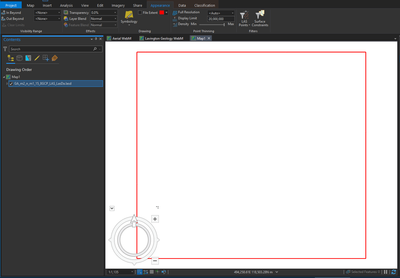

In both maps and scenes Pro displays just the extent when zoomed out, not allowing an overview of the data. I have to zoom in to 1:128 to see the points in this drone derived LASD.

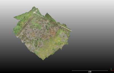

Compare this to CloudCompare
When zoomed in the point display needs a lot of tweaking to get a good quality rendering of the data and at high resolutions display is slow. In a dedicated point cloud package this is managed much better. I would hope that ESRI can improve on this performance. In the screenshot below you can see the points slowly being rendered on zoom. It doesn't even cache the views, this happens on every zoom level change.
