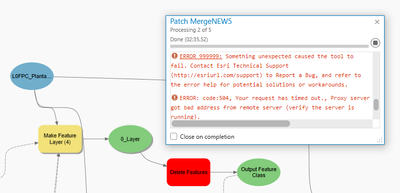

I'm trying to use the "improved" Delete Rows tool in 3.1.....except it isn't working. I've removed my python script tool which was doing a Truncate and Append process (as that seems to be dodgy now I'm in  3.1 as well) and replaced it with Delete Rows and Append, but it keeps returning a 999999 error. Also tried the Delete Features tool with the same result. The Truncate Table tool still doesn't work for me as I can't find a way to change my feature service to support the Truncate option.
