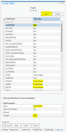

An alternative option:
Create a table from scratch using Catalog and import the fields/schema from the CSV, instead of importing the CSV as a new table. Creating a table from scratch would allow me to easily adjust the imported field types and lengths while creating the table.
