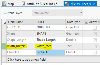

Currently, if we rename a field, the field alias stays the same as it was before we renamed the field:
We often don't think to update the alias when renaming a field. The old name doesn't apply anymore, and is often downright misleading. Especially since the alias is used as the field header in the attribute table, not the field name.
Intuitively, when renaming a field, we'd expect the alias to be reset to the field’s new name.

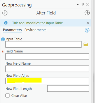

JonathanNeal
The Alter Field tool has a new display name field.  I believe this satisfies your needs.  If not please explain further.

Bud
@JonathanNeal In the Fields View, if I rename a field name, then I want the Alias to be automatically changed to the new field name.
@DonaldRees No, it's not a derived/automatic alias. I had entered it manually (previously).
