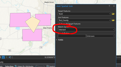

The ability to use the Join in the Spatial Join tool for the fields is awesome. It currently has the ability to intersect underlying data and return multiple features intersected in 1 attribute. It would be a great benefit if there was an option for using an Identity rather that the intersect option for see where non-intersecting areas exist. In the screenshot below it is nice to see what features the tan shape intersects the pink, but it is sometimes required to see where the tan feature is not intersecting anything.

@MargaretCrawford I do understand you could use the Identity, Identify, Union, and a number of other tools in conjunction with the Spatial Join to identify which areas do not overlap. I am more looking for the Spatial Join to use an Identify rather than intersect when using the Merge Rule - Join. Below you can see where boxes B and C fall outside of the number boxes. It would be useful to know that they fall out of a spatial join as well. Many situations popup (wetland mapping, biological habitat, survey tracking...) where a "No Value" or "None" is just as important as the intersected areas. For the spatial join it would be useful to include None for example in the image below for box B the join result would be 5,6,None and the result for box C would just be None.
