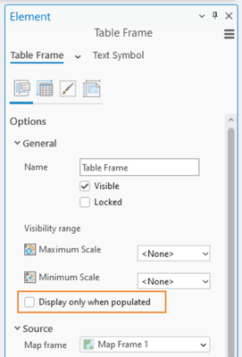

Status changed to: Implemented
This is implemented in ArcGIS Pro 3.4 with the Display only when populated option for table frames, legends, chart frames, and pictures. Go to Your Ideas in ArcGIS Pro 3.4 to see other ideas implemented this release and check out the What's New help to learn about everything that is new and improved in ArcGIS Pro 3.4.
