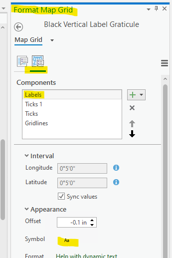

Adding a halo to grid/graticule labels is currently possible.
1. Select the grid from the Contents pane and open properties
2. From the Format Map Grid pane click the Components tab
3. Select the labels you want to add the halo to from the components list
4. Click the Symbol button

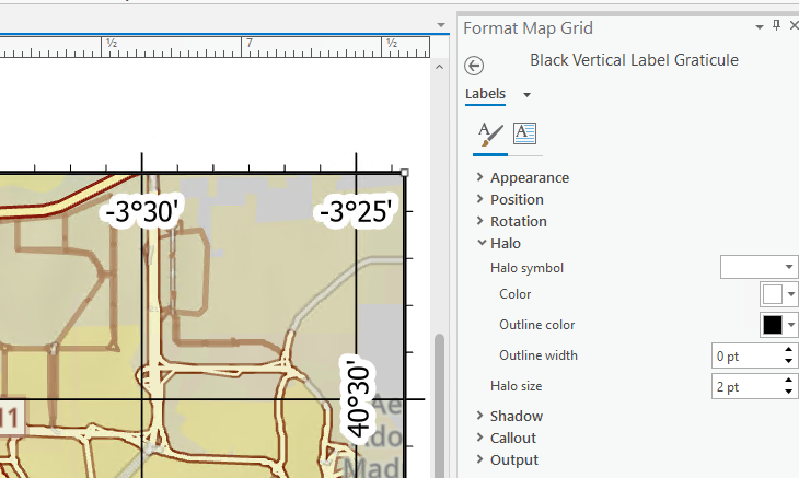

This should take you to a new pane where you can set properties for the label text. Most properties are supported, however, you should be aware that due to the unique nature of grid/graticule labels the many of the position properties, such as Offset X and Offset Y do not work in this context.
The good news is that most of the properties that effect display, including Halo, are supported.
Here is an example.

As Tom mentions, halos are supported in ArcGIS Pro. Because of that I'm going to close this as already offered. If there are additional proposals for formatting grids and graticules please add them as new ideas.
