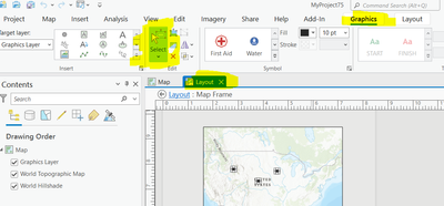

JeffBarrette
Hello Mary,
I'm able to see the select tools after activating a MapFrame on a Layout.

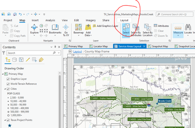

MaryDavis1
Hi Jeff,
Thanks for the reply.  This is what I see; I don't have the Graphics menu when I activate the Layout (using version 3.0.3):
