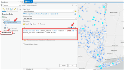

Technically you can do it today. We do not have any UI that allows you to construct that kind of where clause with subqueries but you can simply switch to the SQL mode and write your sql in there.
Here is a screenshot where I selected airports that has runways (in a separate table) longer than or equal to 10,000 ft.
Of course, you use do the same in the Definition Query page to filter them out instead of selecting them.
There are two version of the sql I'm providing here:
-- option#1
exists (select 1 from AIRPORT_RUNWAYS r where r.LENGTH >= 10000 and AIRPORT_FACILITY.FKOBJECTID = r.FKOBJECTID)
-- option#2
FKOBJECTID in (select FKOBJECTID from AIRPORT_RUNWAYS r where r.LENGTH >= 10000)

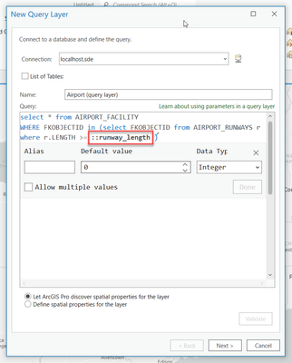

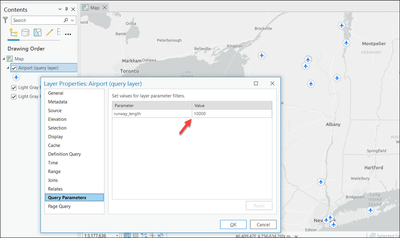

TanuHoque
@MarcusVowell_Uniti
As @jcarlson said above, you can also use query layer if you want.
Query layer can have parameters too. And that is how you can update values in a where clause without re-create (or updating the source of) the query layer. See screenshots below.
As you know these queries can be very complex.
