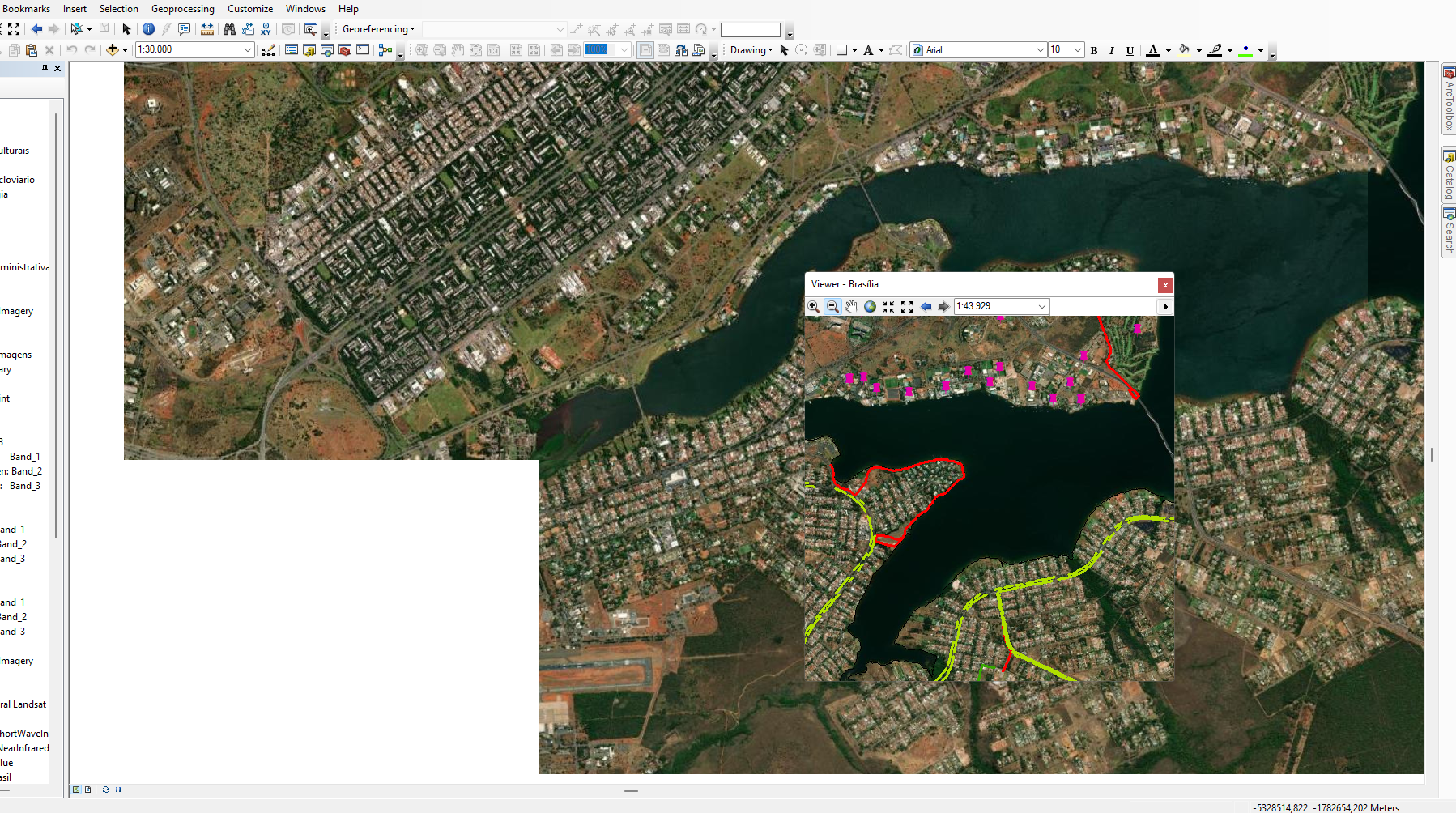

In ArcMap, when I needed to perform georeferencing, I used the 'Viewer' tab so that I wouldn't have to use 'Zoom to Layer' on the layer when adding control points. In ArcGIS Pro, I am unable to replicate this process. I suggest adding this feature, as it simplifies the workflow when georeferencing images:

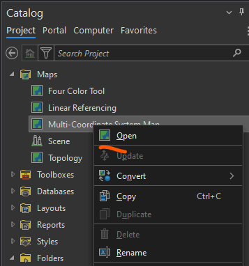

In ArcGIS Pro you can open multiple views of the same map and you have options to do things like Link Views, Link Cursors, and so on.
To create a second view of the same map, just Open the map a second (or third, or fourth...) time.
Does that help with what you're trying to do?

I've tried opening two instances of the same map view with one zoomed to the ungeoreferenced image and one zoomed to the target location, to try to replicate the ArcMap viewer window. Unfortunately that is not a solution. The Add Control Points tool couldn't handle clicking back and forth between two map windows (or two views of the same map).
