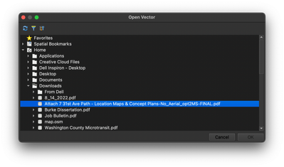

@TomDe_Leus1speaking of QGIS's georeferencer, have you had any luck with the new vector capability? I can't find much documentation (3.26 is so new) but I'm not able to select my PDF. Some PDFs expand and show frames, but not this one, which is a CAD drawing.
