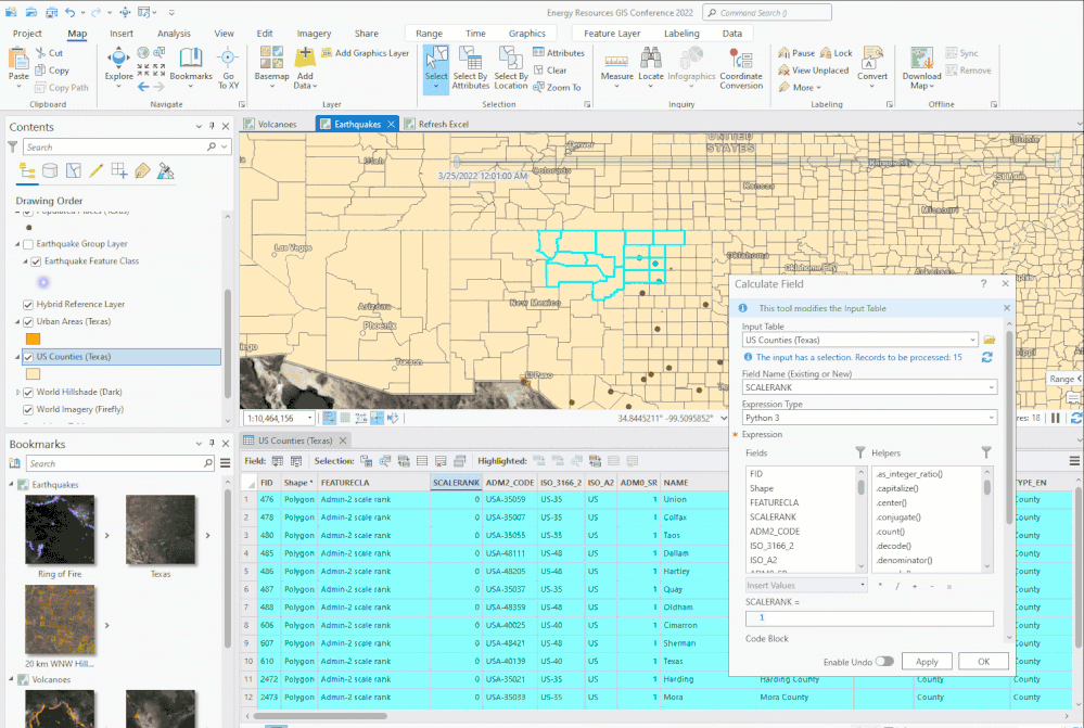

Currently GP tools are set to run on all records in a feature class, or in the case of any having been selected, the tool will only be performed on those selected features.
In the various dialog boxes, it should be possible for ESRI to have them point out when the GP tool is set to run on just a selected subset.

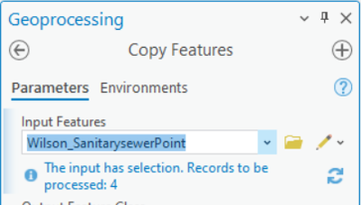

@EricPescatore We have it implemented using parameter messages.  It will defer to report the selection count.  If there is no selection, it will instead count definition queries, timeslider filter, or range value filter.

I almost never run a calculate field without the attribute table being open. It appears the attribute table is open in your screenshot also. On the bottom left of the attribute table, I glance over and look at the "selected" number. It's basically a toggle between the entire table and the selected records of that table.
I have ran calculate field too many times on a single record and scratched my head thinking my arcade expression was not working.
Hope this helps.

Thanks for bringing it up, we added it for all tools that accept layers here.
