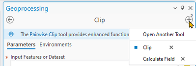

Hello Andrew,
The behavior you're looking for was implemented following this user idea in 3.2.
Just some additional info, in case you're not aware:
You can have multiple Geoprocessing tool open at the same time.
Click here
and select Open Another Tool.
The number tells you how many tools you have open and --important-- to access any of the open tools, you need to open them from this dropDown menu.
