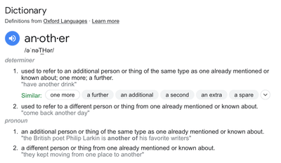

@BBicking1 What is meant by the word “Another” in that context?
  • Additional tool
  • Different tool
  • Either additional or different
I’ve always found that word to be rather ambiguous (in the English language in general):
https://www.google.ca/search?q=another+define
BBicking1
Additional tool, if one is already open, like in your case.
One tool needs to be open for the option the be active.
Different tool from the one currently open, as your case suggests.
It can also be the same tool multiple times with different parameter settings.
In SUM: Another tool.
