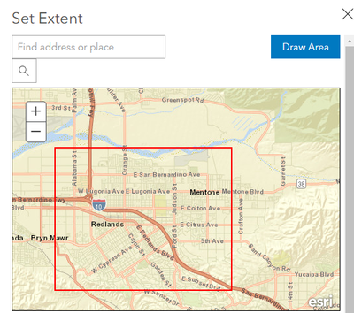

I just did a quick test.  I created a locator view called Redlands Locator View in ArcGIS Online.  I set the extent just to the Redlands area:
And I can then add that to Pro and use it!
I think that should do what you're asking for this idea, but if not, let us know.
